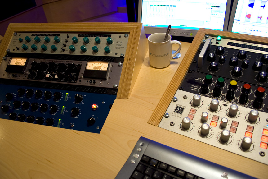

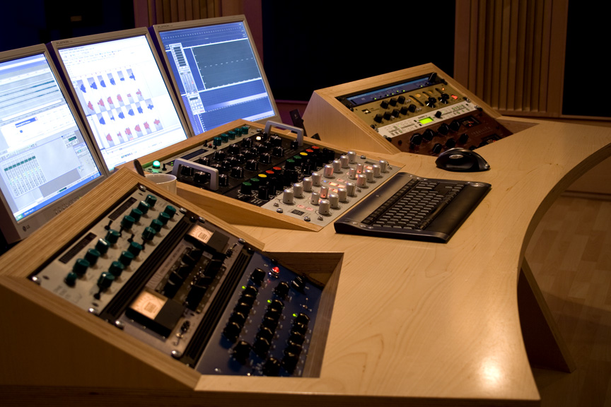

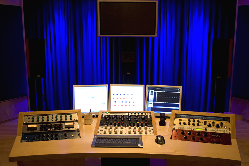

Sorry for the delay in my reply. To compensate, I went a bit over the top taking pictures Wink Here goes:
Desk, front view.
http://www.24-96.net/xchange/001.jpg
Side view.
http://www.24-96.net/xchange/002.jpg
The left and right racks have a 30 degree angle with ca. 3 rack unit heights submerged below the table top. The middle rack is not submerged to allow more desk space in front of it. It was added long after the initial build and only has a 12 degree angle  because otherwise it would get in the way of the screens.
Operator view onto a submerged rack.
http://www.24-96.net/xchange/003.jpg
From operator position, all controls are visible.
A nice bonus with having the submerged rack thing is that it's actually kinda nice to be able to rest your wrists on the table while operating a unit. Very relaxed.
