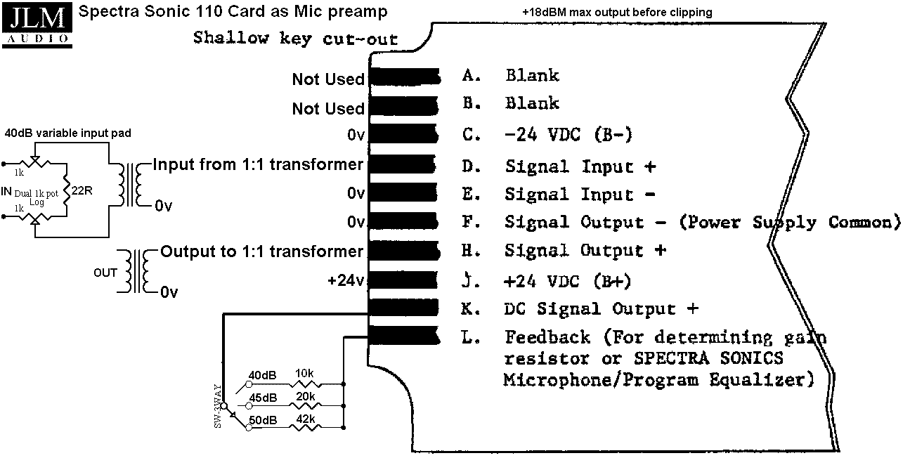

You say there are two 101 cards there, Billy.
Is it like the diagram I posted, or do the mic and eq stages each have their own amp? If the latter (where it wouldn't restrticted to using only a resistive pad for mic gain), this feedback gain info may be useful.
BTW, K and H are both output pins, with the difference being that H (which is used in the above diagram with the eq in the feedback loop) has a coupling cap.
index.php/fa/11660/0/
Here's and idea for a variable input pad from Joe Malone (note #110 card - bi-polar supply version):
http://www.jlmaudio.com/Spectra%20Sonics%20110%20as%20mic%20 pre.gif

Like Phillip and myself, there is undoubtedly a need for information regarding Spectra Sonics equipment and this forum has certainly been a pinnacle for info gathering and distribution for the members here. I have compiled a nice set of documents courtesy of my friend Richard Dobson, who generously loaned me two spiral bound copies of the operation manual and architectural drawings including the single line schematics of the 1024 console, which was a standard model platform that many custom consoles were built from. Unlike the Ardent style desk, this one used 110 amplifier cards which used a bipolar supply +- 24vdc. The 101 cards used a single +24vdc supply, but the pinouts for both are the same with the exception being, pin C as the -24vdc leg (B-) for the 110 card.
